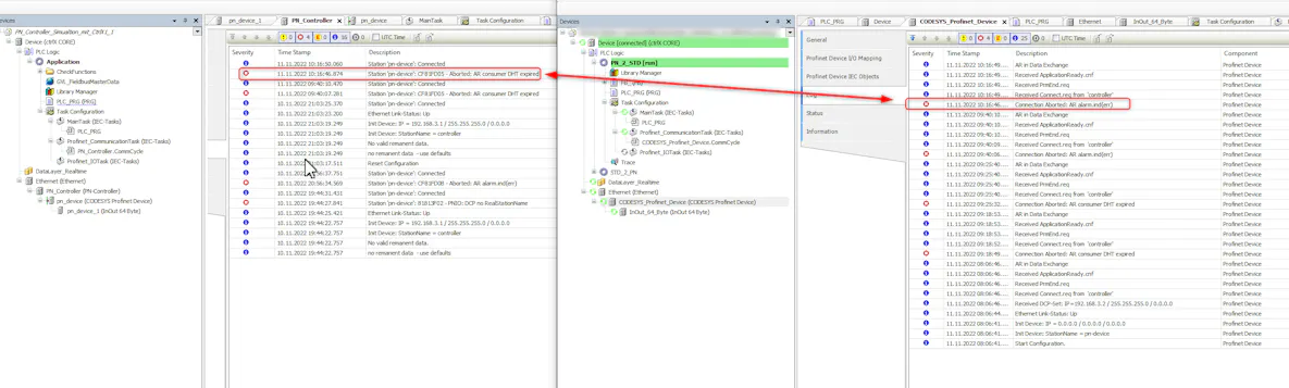

ctrlX1 Softstack PNController talking to ctrlX2 Softstack PNDevice -> DHT expired

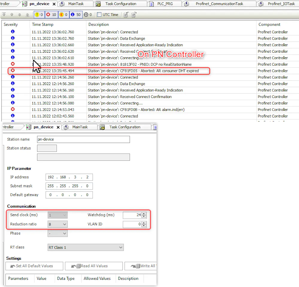

Connection is established and PNController operates with SendClock1ms RR= 8 ->8ms.

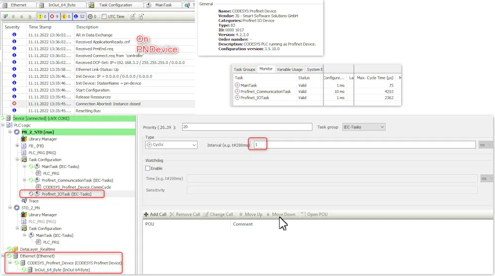

PNIOTask is calc cyclically every 1ms. What may be the reason to the connection loss. Is it reasonable on Controller or Device Side?
Instead of increasing the reduction-rate I wanted to set the sendclock directly to 8ms.... that is not supported so far. Any reason that it is greyed out? Failure in gsdml?
It seems that the PNdevice side is reasonable for the HDT failure, since a colleagues operating the PNController with PN-IO newer so that messages.
Could you please provide details of the failure case... what are the criterias to through the failure? is the PN-WD setting basically the criteria? What would be strange since
And what about the "naming" baptiste at the beginning ot the PN Connection. I do not see the given name in the PN-Device... If I could get some further details - that would be great.
