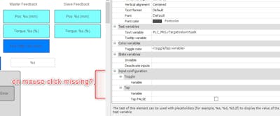

I made a small HMI using the visulazaiton tool in CtrlX Works, the same way i used to with Indraworks. The problem is that i can't find a way to enter data into my variable because the Input Configuraiton is missing the "on mouse click" feature in the properties window.

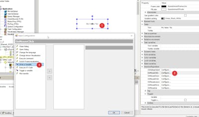

Here is what i looks like for Indraworks:

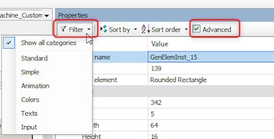

Best reply by HmiGuide
Did you check your Filter settings and the Advanced checkbox in the Properties window?
Here you can define, what properties are displayed.
