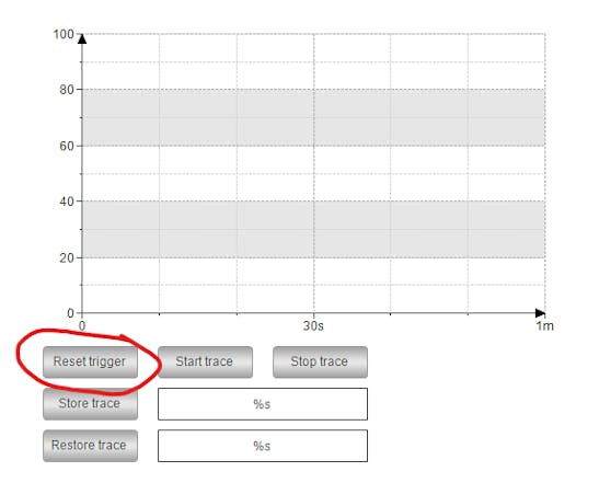

Trace element triggering the reset button does not reset the trace graph.ย

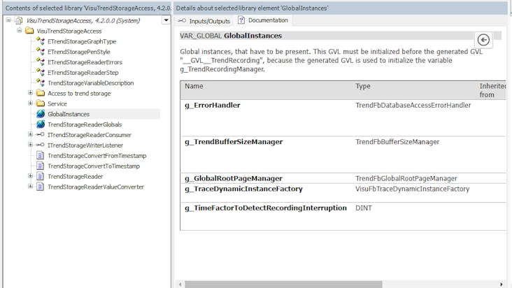

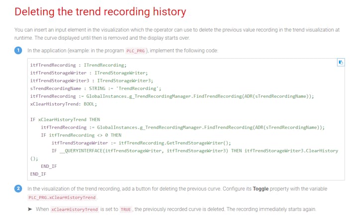

As for trend graph, i tried following codesys online help (below) deleting the trend recording history, it seems the VisuTrendStorageAccess library does not have the GlobalInstances.g_TrendRecordingManager variable to find the trend recording.ย
https://content.helpme-codesys.com/en/CODESYS%20Visualization/_visu_trend_programming.html

The trend can be reset as described with "Deleting the trend recording history".
The trace cannot be reset. It continues to run. You can start and stop the trace, but there is no reset.
