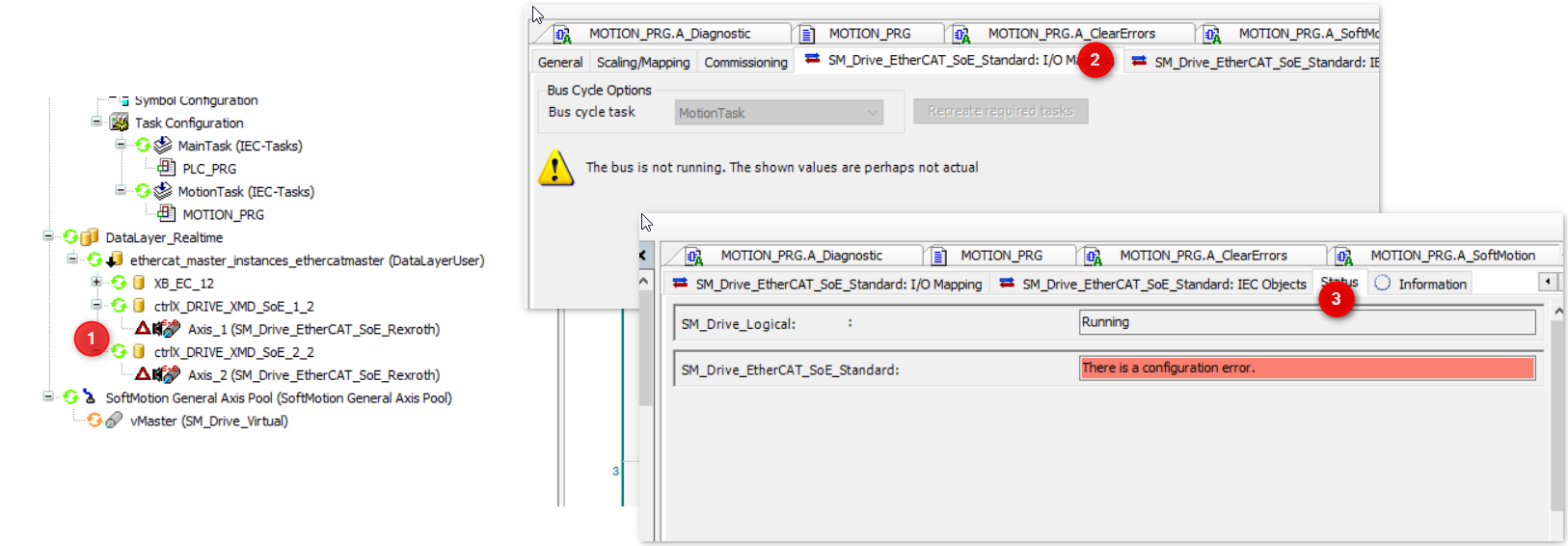

I'm testing the SoftMotion 4.12.0.0, with SoftMotion Adaption 1.16.0, on the new CtrlX 18.1.0 plus the CtrlX drive firmware 3.14.
I'm not able to reset SoftMotion error shown if Fig.1. ( red triangles next to point 1 - yet I see spinning arrows when ok )
I can easily bring out that error by temporarily un plug ethercat cable to the drive or other severe actions.
Btw, I only managed to recover it by a build-clean and full download or cpu reboot.

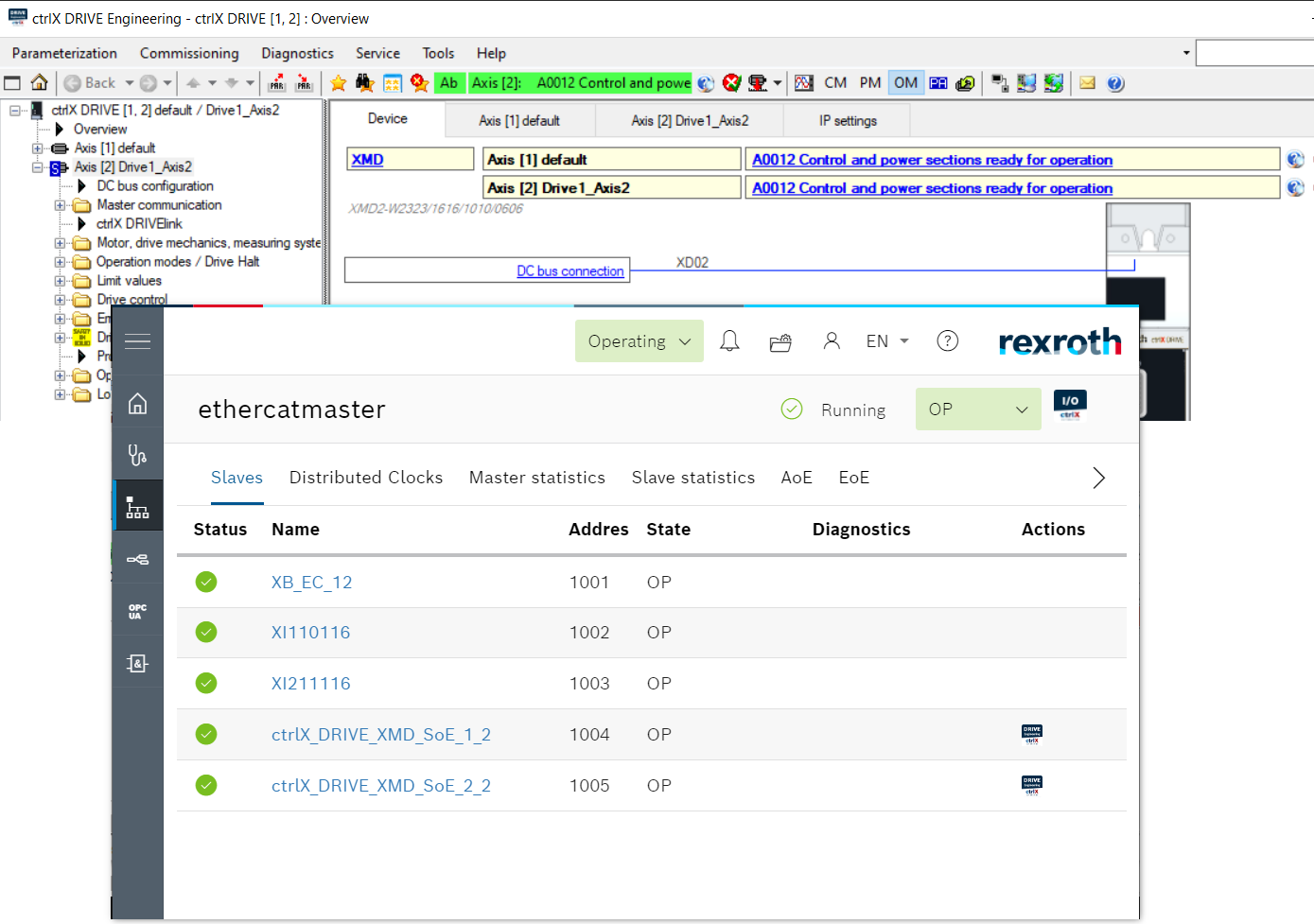

If I don't, motion doesn't work despite of drive, cpu and ethercat errors have been successfully cleared. ( Fig.2 )
