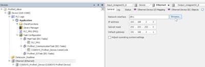

we found an issue, that currently PROFINET Device/Controller can not be used with ctrlX CORE. We are working on a solution.
To use the CoDeSys PROFINET functionality, you need
  • the corresponding license
  • to install the corresponding packages (Ethernet and Profinet)
  • add the Ethernet Device
  • add the PROFINET Device/Controller
Then the two tasks and the corresponding nodes in the device tree are created.
Because the standard priority does not fit to the ctrl CORE ones. I recommend to set a high priority (e.g. 30) Profinet_IOTask and a lower priority  (e.g. 38) to the Profinet_CommunicationTask.
Additionally you have to assign the Ethernet port for the PROFINET communication. If there is any communcation to the ctrlX  CORE You are able to indicate the available interfaces by using the Browse dialogue and chose the right one.
Then you configure the Profinet configuration and it will run.
