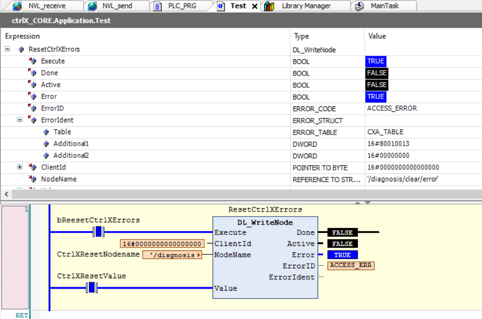

What is the best way to clear or acknowledge CtrlX errors from PLC?ย
writing into the datalayer commands does not work. Any sugegstions will be appreciated
Thanks
Thanks
you already have the correct function block DL_WriteNode. For a global clear error, you have to write to this node:
strDL_DIAG_CLR_ERROR: STRING:='diagnosis/confirm/error'; // global clear error
Do not connect a variable to the input Value. This has to be empty.
Hope this helps,
Klaus
P.S. the nodename changed in (i think) RM21.03. So for versions before RM21.03 it is 'diagnosis/clear/error'.
